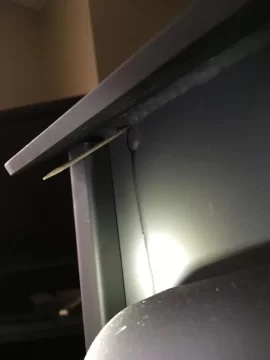

Took a better look wih it cooled down. The weld is just not over the seem, it runs to the right.
I can fit a tooth pic in it, and its a nice flat butt joint. So the welder just missed the mark.
I understand that it should suck air, not sure what to say. The stove works great. I looked in the chimney as you guys made me paranoid.... it looks perfect, light brown dust neer the top but barely enought to get my finger dirty. In the stove its black for the bottom half of the stove, and brown light and flaky around the cat and top half. The window is about 1/3 coated.
Grabbed a few splits from the pile.... 10-16 mc this check.
Draft in the cold stove sucks a papertowl up into the pipe...
It seems to purge smoke out the crack more vigorously at full tilt with a raging fire. Back it down low and it slows down. That seems the opposite to me as well.
I'm going to spark up another fire just to try getting a video.
After looking at it i know i can fix it as i have 100% found the leak. But i will wait for BK's answer.

Put some foil tape on it, have a rager burning in her now! Lol No smell, no smoke.
Watching the smoke inside I did notice it eddies up above the air wash vents due to the fresh air rushing in and literally the smoke curls and runs into the front of the stove behind the airwash, over and over. This is right where the hole is.
Which makes sense why it literally streamed out when the stove was cranked up as the air flow was fast and the eddies were strong ramming into this area making a high pressure zone. Once turned down it gets a lot lazier.
