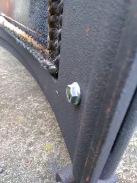

The offending long bolts in the first picture. Second picture is the dent/chip it left on the front plate of the stove, and third picture is the offending bolts cut off.
