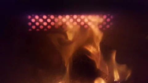

Tonight's load
[Hearth.com] 2017-18 Blaze King Performance Thread PART 2 (Everything BK)
40 minutes later burning on "2" or 3 o'clock for those without numbers with the fans on medium.
:eek: Stove is so repeatable and easy it's silly! ;lol
