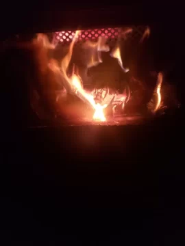

So after a full week I am very pleased with this stove. It was -5 degrees here with whipping winds last Wednesday and today it is 63 degrees outside so I feel like I got a good sample of how this stove will perform in all conditions.
20' masonry chimney with good draft.
No OAK (as I have an older drafty house and didn't feel the need for it)
No blower
I do have a few questions after a full week of letting the stove run and I'd be appreciative if those that know Blaze King can share some knowledge.
1. When it was close to zero degrees for a few days I was running the stove on high almost all of the time. Will this damage the cat or stove if I run it on high for a stretch of a few days? Also, as you can see in the photos, the cat is way up in the active zone, but the stove top is below 400 (it is only above 400 right near the thermometer). The pictures of the stove top temps were taken with the stove on high for a few hours. I have seen people say their stove tops are a lot higher than 400 so I'm wondering why mine won't get up that hot.
2. When I turn the thermostat anywhere between medium and low the catalyst probe thermometer slowly tarts to creep towards the inactive zone and eventually stays in the inactive zone. I didn't know what I should do, so I turned up the thermostat to high and opened the bypass until the thermometer was back in the active zone. Is that what I should be doing? Secondly, why is it going to inactive even when the thermostat is at medium?
Thanks a lot guys, I am grateful for your thoughts.

No, stove was on high (and burning on high for a few hours) when the pics were taken
For what i am seeing in the first picture you at coal stage. Being jacketed i will think it is ok. They are good convective stoves. At that point I dont know if the surface will be too hot but it suppose to give good heat into the room still. .

The cat meter is only to be used for on/off or active/inactive. Don't worry about how high it is going. If your door gasket is in good shape then you may run the stove at maximum high thermostat setting all day every day.
Now on the low end you need to be careful that you don't turn the thermostat too low. What will happen is your cat meter will fall to inactive. That's because you snuffed the fire and the cat starved. Open the bypass and apply full throttle until the cat meter is above the active line. Then you can turn the thermostat down again but not so low this time. You will eventually find that setting that is just barely high enough to keep the cat active. Be sure to stay above that setting so that you don't stall the cat again.
Reactions: Dave K
its below 20%. Are you asking to answer my stove top temp question or the thermometer going inactive at medium question?
Thermometer going inactive. In most cases the wood condition is the cause.
Oh and don't measure stove top temperatures. It's useless. The cat is usually cruising at 1500 degrees!

1. No issues with running on high, provided your chimney isn't massively over-powered. At 20 feet of masonry, I doubt that's the case, you should be good to let her rip.
2. I find the lowest setting I can run without stalling is somewhere around 2:30 o'clock on the Ashford 30.1 swoosh. Every install is different, but consider that a reference point, your setup is not out of the norm.

The thermometer goes inactive well after the wood is charred. Would the all moisture be gone from the wood by that stage? Also, my wood is dry.
Maybe then you are closing the stat too much for your set up. You must learn to become one with your stove.....(kidding).

So hypothetically, let’s say the cat thermometer falls to inactive while I’m away from home and the bypass remains closed because no one is there to turn up the stay or open bypass. What happens to the stove/cat? Anything to be concerned about? I’m assuming it wouldn’t have enough air and it will just die out.
Okay thanks. So I just have to find that sweet spot where it’s the lowest I can go with keeping the cat active.
So far, I can’t go any lower than 5 o’clock. Is that normal for some setups?
Lol yes. There is definitely a learning curve. So far I’m absolutely in love with this stove (coming from an old smoke dragon)!
