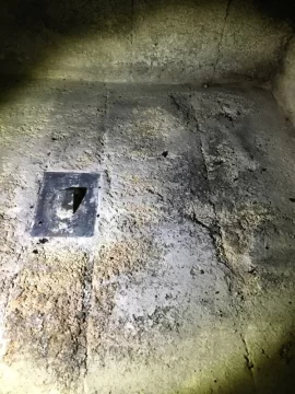

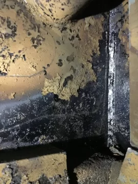

After a successful sweeping and cleaning of the bk after 7 years of service I found some deteriorated floor bricks. I’ve never seen this before. The bk bricks are a low density looking thing but there is usually a lot of ash under the coals. Is everyone else seeing this in their bk stoves?
I know that the bricks are two layers thick on the bottom and I could flip these over if I want.
Oh and the back corner welds look nice and fresh. No sign of corrosion or pitting.
