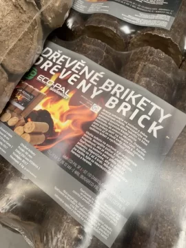

Question is ? Blaze King Ultra and Princess, will like this type of food too ;-)
I can't read the packaging.
Research the product.
100% wood compressed logs are OK. They are held together by the wood fibers which fuse under great pressure.
Lightly compressed sawdust logs held together with glue are probably not OK.
I would be careful... cat poisoning is always behind the door. Burn clean, seasoned natural wood is the best (only?) way to have a long cat life. Unless you are 100% sure that those logs do not contain additives of any kind.
The package says compressed wood with no binding agents.
Nope, it says lignite with no binding agents... lignite is coal (well, basically) but I know nothing about burning it in a BK. Anyone out there tried coal in a BK? We need a little help here.
If it's 100% wood, it should be okay.
I am guessing the lignite thing is a translation issue since the product appears to be tan in color. They also refer to the form of their product as "briketts", so it's reasonable to guess that nobody with English as a first language was involved.
Sorry HighB, my English in not good but I thought lignite was a correct translation... see
https://en.m.wikipedia.org/wiki/Lignite
If the correct English word is different, I apologize... after all, I’m Italian!
LigniITE not lignIN.
I read that they are different things. Lignite is peat coal, and lignin is naturally occurring juice in trees.

The sulfur in coal will KILL the cat. It will also void warranties to burn coal or coal byproducts.
But what about burning coal in a BK? IIRC, the factory recommends (strongly) only cordwood...
Yeah, the instructions on the Union Brikettes say "suited for use in modern heating stoves provided these are licensed for lignite briquette operation." Stay away with BK. As mentioned above, 100% compressed wood is OK. But the compressed wood bricks may be hard to find in Italy, I don't know.
Compressed wood bricks can be easily found in Italy, but are not cheap like Eastern Europe made lignite bricks... Actually, they cost much more than proper cordwood, split and delivered to your door hence the Union coal thingy
