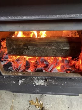

Jacub said on a "low burn," but we don't know how low that is compared to your burns, how much draft he's got etc. Granted, you must be running the 24-hr stove pretty low..unless you are milking the coal bed a long time and the actual load burn has a decent amount of air being pulled through.
At 24 hour settings the results can vary day to day, as small factors leverage into big changes over that time scale, but I usually have enough left in the stove that I burn it on high a half hour when I get home and before loading, to burn down what’s left. Then occasionally I come home to nothing but ash and a warm stove, and wonder what happened, possibly a wood fiber in the gasket, a slightly less dense batch of wood, or my knob setting was off 1 degree. Note that the difference between my 12 hour and 24 hour settings is maybe less than one hour on the o’clock face.
Thanks for the tips guys! Burning down the coals with a piece of pine, thermostat on high.
