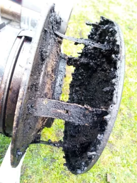

So it's been 28 days since I swept the pipes and this is what they looked like this afternoon when I took them apart. And bear in mind we had about a week or so of "cold" weather where we burned a lot hotter than we usually do. No, I'm not burning Bridgestone's in my stove!
[Hearth.com] 2019-20 Blaze King Performance Thread Part 1 (Everything BK)
The cap looked like something from a science fiction movie...
...another half gallon of flake. This didn't include the 4-5 cups that got brushed into the stove.

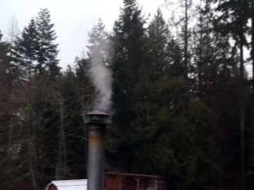

The early results are outstanding. Cat probe was at 2 o'clock within the hour and just a wisp of steam at the top of the pipe.
Along with the creosote build up I've been experiencing, I was also waking up after a 10-12 hour burn and seeing great plumes of smoke drifting across the yard.

So it's been 28 days since I swept the pipes and this is what they looked like this afternoon...The good news is this bad boy got delivered to my dealer yesterday and was installed after the cleanout.
Yeah, looks like you were about due for a new one! ;lol
Damn, Steve! I don’t see even a fraction of that build-up after putting 6+ cords thru my main stove! Let’s hope the new cat resolves it.
I usually see 2 o’clock on the cat probe 25 minutes of a cold start, and less on a reload, even on my 2nd year cat. Are you saying it took an hour to get there on a brandy-new (typically over-reactive) one, or is that just when you happened to check it?
Sorry if I missed it. How old was the old cat?

I also swept my chimney before my cat replacement last week. Didn't take it apart to get those great photos but the debris was black and flakey like your photo.
My cap looks like yours but the deposits in the pipe only look that bad when the cat fails. Failed cat plus smoldering softwoods make a pretty good recipe for a gunked up flue. This is the stuff that gave pine its bad name.
Did you get a ring of black drips on the roof flashing? My storm collar will get a nasty ring from the cap droplets.
Oh yeah. If you look at the chimney pic you can see the top foot is quite stained, the collar looks just like that.
