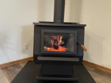

Pipe installed. First fire rollin’. Have it set at about 2:30 and cruising. Paint curing isn’t too bad.
[Hearth.com] 2020-21 Blaze King Performance Thread (Everything BK)[Hearth.com] 2020-21 Blaze King Performance Thread (Everything BK)[Hearth.com] 2020-21 Blaze King Performance Thread (Everything BK)
First fire rollin’.

It’s odd that you were able to drop the outer wall onto the stove top. Does it feel like the tapered inner wall of the flue pipe is tightly pressed into the stove collar? I had to use a short piece called an appliance adapter between the stove and the double wall.
i never got mine to seat perfectly. It’s a poor design in my opinion. The stove pipe should fit securely in the stove collar but my experience was far from it. My stove pipe is basically just resting on the colts. The flue pipe is as tight as can be in the stove collar but not perfect. Last year I shoved some gasket rope up in there and tried to fill the gap between the collar and the stove pipe but it eventually fell down.
As long as there isn’t a way for the stove pipe to fall off the collar I don’t see a big deal. Your draft is going to make sure the smoke goes up and not find a way out of the fit isn’t perfect. At least that’s been my experience. But again, I was quite unimpressed with how they fit together. Seems to me there’s lots of room for improvement here.
The part that threw me a little bit was how high the holes were on the collar. Seemed to imply that the pipe should sit up from the stove deck. I suspect it has something to do with having to support multiple different stove pipe manufacturers. I ended up taking Begreen’s advice and dropping the pipe pretty close to the stove top. Getting the screws lined up wasn’t perfect but I’m happy with how secure it is. I don’t think it’s going anywhere. First fire going now and I have not smelled a whiff of smoke ( and would not expect to with a good draft). I’mvery happy overall. That said, I can see why people pay to have this stuff installed. If you’re not use to it, it’s not necessarily super apparent how to proceed.
Good call. With mine, there was absolutely no way it was going down far enough to be flush with the top of the stove. The crimped inner flue pipe would barely fit in the stove collar, so it was fairly snug. But the straight inner flue pipe was almost the same diameter as the stove collar. So my stove pipe sits about an inch or so off the stove top. Again, never seen a whiff of smoke either.
