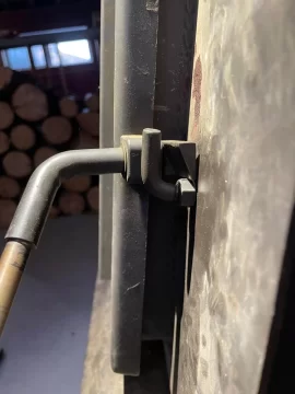

My son just bought a house with an older Blaze King Princess stove and when closing the door the latch does not force the door closed. Looked at the manual, and even with adjusing the threaded catch all the way in (as shown in the pictures), the door is still "open" and I cannot figure out what the issue is. Anyone have any thoughts or suggestions and thank you for the help.

It appears to me a part is missing here?

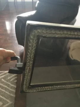

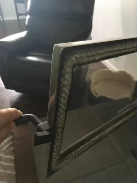

Is there a gasket in the door?
There is and it looks in good condition but I purchased another for it so could replace it. I see that there is an uprgraded door handle kit for it, but it does not appear from the photos that there is any difference in it so am hesitant to order:
There is and it looks in good condition but I purchased another for it so could replace it. I see that there is an upgraded door handle kit for it, but it does not appear from the photos that there is any difference in it so am hesitant to order:
That is not an upgrade. It's either an identical replacement or a new handle for the newer stoves that required a different degree of angle in the handle.
The handle passes through a black block on the door. Is that block secure and tight? If not, you can tighten it, the bolts are allen head bolts located under the gasket.
Post a picture of the door from the inside showing the gasket please.

The block did not appear overly loose (will check it when I have access again) and will post up another picture later today when my son gets off work. Thanks very much for the help....

I betcha the gasket is some off the shelf product that is not equivalent to the robust bk product. I wonder how much damage has been done running it with such a huge air leak?
Or the gasket isn't there...I'm waiting for images....
Reactions: Highbeam
Yes wrong gasket. Please visit with a Blaze King dealer. You need our dense 7/8" gasket and it appears to be a solid door and that gasket is also failing.

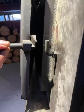

Here’s what it’s supposed to look like with bk gasket. It’s thick. This gasket is also a few years old with lots of use.
