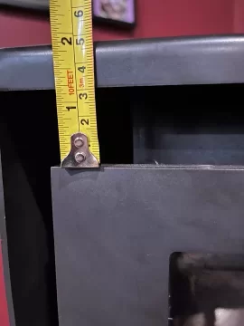

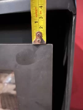

I noticed tonight that the door on my new Boxer is sagging about 3/8" or 1/2 cm, from the hinge side to the latch side. I can grab the bottom of the door and lift upwards. The play seems to be in the two hinges but tightening the bolts only made the door harder to open and not straiten it out. I checked the manual which covers sliding the hinges to tighten the door gasket. I can't see that taking a sag out of the door. Also the Allen bolt and 9/16 nut are very hard to loosen or tighten for that matter. I was thinking about adding a washer to the bottom hinge bolt to lift the end of the door upwards. I can also see the door gasket line slowly run off center matching the sag in the door. I didnt want to try much else without seeing if there is a solution to leveling the door
It's important to get that corrected so that the door gasket seats correctly. Is the dealer helping you?
View attachment 298720 View attachment 298721
I think we have two different topics in this thread. The BX24 does run down slightly. If you look with the door open, you'll see a little "shoe" that the door ramp up. You can put a small shim in there as part of leveling the door. Is this a new stove? Have you contacted the dealer? It's adjustable, but be careful not to over loosen the adjustment nuts on the hinge side.
Contact the dealer first please....call us if you need more assistance.
BKVP
I haven’t contacted the dealer, I just noticed it today. The stove was a floor demo model with some use. I was told by the dealer the warranty covers it as a new stove. I did loosen the hinge bolts because the manual says that’s the way to access the hinges to tighten the door gasket.
BKVP
Was it closer to level before trying to tighten the door gasket?
reaperman1
Aug 7, 2022
100
Minnesota
I didn’t do anything to the stove before I noticed it was sagging. I was sitting in a chair looking at the stove and thought the door didn’t look level. That’s when I measured it and saw it wasn’t level, then I checked the manual which didn’t say anything about adjusting the level. Then I tried to adjust it. No difference after tightening the two hinge bolts. Like I said before, it only made the door close harder.
I also looked at the door and didn’t see the little shoe you were referring to that ramps the door up. I would assume that would be on the hinge side correct?

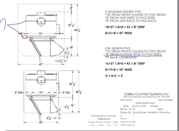

So I have posted on hear about a year ago about my current stove set up. Sens Then I did as was said and had some one out. I had a wood burning insert (that pervious owner changed to a vc wood stove but left insert) it seems to have a 12 inch outer liner and a 8 inch iner ( not sure what that's called perhaps "Coaxial pipe" ) In any case I Am told it should be changed out to Class a double-wall all-fuel pipe.
My ? is this diagram stats 8 inch from "front Flange Sides to pad sides.
IS that stating that it needs only 8 inch's to a wall or other object from the front of Conner (red) or the whole side or just the area in blue?
Ty for any help.

The hearth pad sizes are not necessarily the same as clearance (to walls etc.)
The 8" is the whole vertical line there (the whole edge of the pad), and it is for the pad. There should be other diagrams regarding clearance to combustibles.
