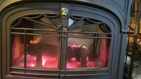

Was that peak cat temp? Or maybe you don't know because you don't stare at your stove all day like I do....![]()
![[Hearth.com] 2022/23 VC Owner thread [Hearth.com] 2022/23 VC Owner thread](https://www.hearth.com/talk/data/attachments/311/311591-7855b178dbeb35ebe00edf4fc6505671.jpg?hash=BwiQ0LCbSd)

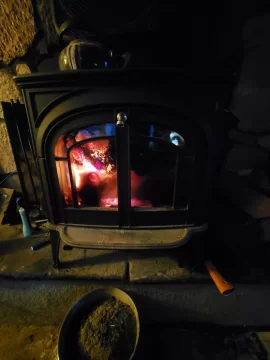

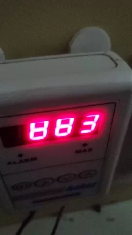

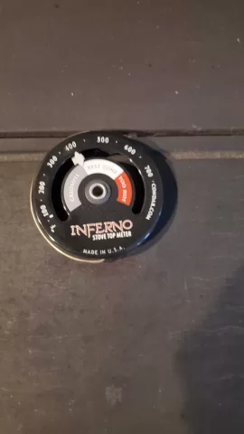

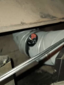

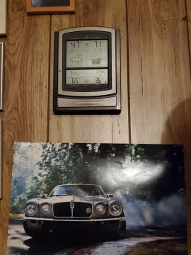

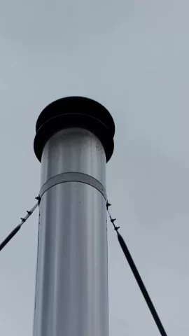

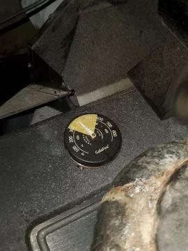

How long is your chimney?Day 4 straight of burning constantly. I haven't been tracking data much passed this since we are into a new pile of wood.
Lows at night about 37 outside and highs of about 55-56 during the day in the pacnw.
We are able to run it with the cat engaged and full throttle on the air until inside temps reach 70ish.
Night time settings are cat engaged and 4 clicks in from full open and we see about 4 hour burns at best with a pine, fir and black walnut mix.
The black walnut burns slow and long.
Just got home from work and attached are pictures of what we have after a warm reload and 1 hour of the cat enabled and full air open. Stove temps stay below 500. They will dip to about 300ish on overnight burns.
Flew temps never get over 250 under any air setting with the cat enabled.
This thing is getting easier to control when outside temps are higher than 28 degrees. Once we see below 32 outside this old cabin is hard to keep warmer than 65 inside.
View attachment 311561 View attachment 311562 View attachment 311563 View attachment 311564
