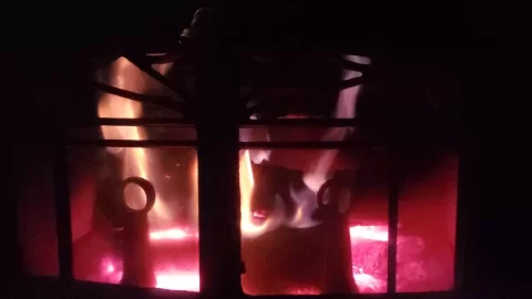

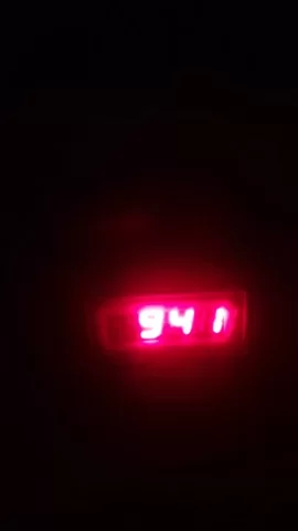

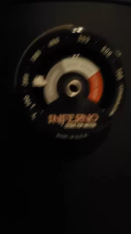

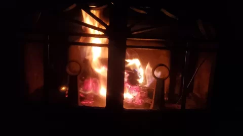

So here is my stove getting up to temperature.. just started the fire stove pipe just at 200 degrees

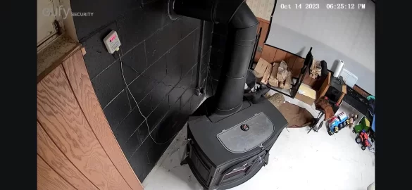

I am trying a new set up to monitor the cat temps while I’m not in the room. I had an inexpensive security camera that I set up over the stove so I can check in on the cat temp and STT whenever I want. It also records 24/7 and stores up to two months of recordings that I can go back and look at it. It isn’t as fancy as @arnermd set up with graphs but this definitely gives me peace of mind that I can check in on the stove. [Hearth.com] 2023/24 VC Temperature discussion thread
