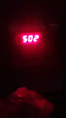

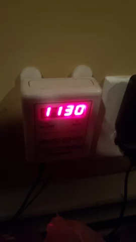

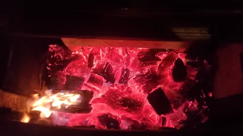

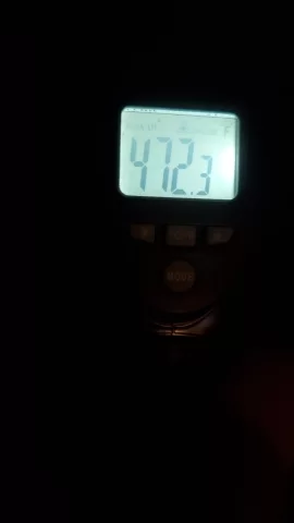

So here is how my stove ran last night. Obviously the stove was running yesterday afternoon and I reloaded on a warm stove. Catalyst temperatures was around 750, coals at the bottom at reload at 7pm exactly last night. I loaded with oak thick square splits. I could have packed it tighter. 5 splits were used. At exactly 11 hours this is what was left in the stove. SST was around 400 and catalyst was 500
Good first overnight burn if the season

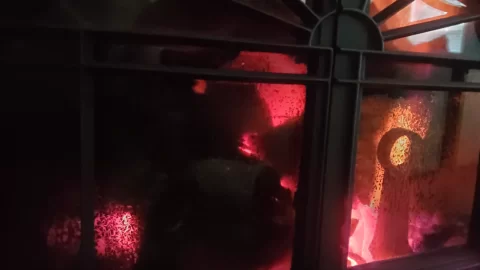

I Just burned off the glass with what was left in the box and with 2 small splits. I loaded 3 uglies in the box and have it turned down to 1/4 air to keeo the glass clean while burning for the long haul.. in an hour or so. Ill probably cut back the air all the way once its off gassed and let it sit like this the rest of the afternoon
I did an ok job on the glass as you can see it burned pretty clean

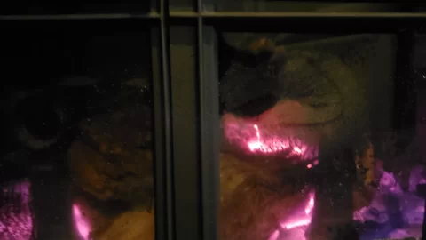

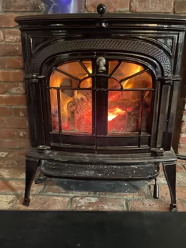

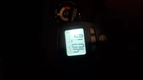

Well got my first fire of the season in today. I woke up as usual and went to work before anyone else got up. About 10:30 my wife called me and said it was cold inside. I check the Nest thermostats and sure enough heat went out. I called the oil company for service. I told the wife to light a fire for heat. I got home and the stove was running great! The house was about 1/2 warm and I was able to fix the heat before the service guy showed up.
Started with some dark glass and I walked in to this unknown STT with an 800 degree cat and semi warm house. This is why I bought this stove for emergencies/power outages.
