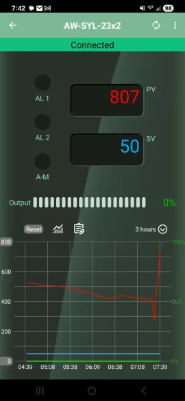

The stove loves the cold! It's been single digits in the mornings this past week. 10hr burn last night on all red oak. This morning the Cat 411, stt 375. Opened it up for 5 minutes to get the coals fully going, added a few splits and already back above 800 and climbing. I try to burn more of the ash during the day and keep the oak for the overnights. Seems to be working well.
Oh yeah it drafts so well in the cold
