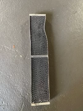

Well my catalyst got BAKED. I had a few runs of cat temps in the 1500's over the last few weeks as I've gotten more comfortable with hitting those temperatures and loading my stove fuller and definitely getting longer burn times. I've actually been loving it. But I guess this catalyst couldn't take it. I did check this catalyst a week ago and it wasn't warped like this. It was actually unremarkable, little bit of fly ash but pretty intact. So I'm wondering if the Cat was dead and because it wouldn't light off, the warp happened. I don't know, I suppose it is what it is. Not sure if this will change my operation much or not. What say you?
I do give Midwest Hearth all the respect in the world - they discounted me $90 bucks on a replacement with warranty. And they told me they've seen much much worse. Glad I had one on the shelf as I'm lighting a fire this afternoon. My chimney looked fine and I didn't sweep, I'll usually do that in early January. Now I'll have another catalyst on the shelf again.

Bro.. Iv never seen a cat warp like that. You get first prize for this. Iv had the ceramic crumble.. Iv even dropped mine on the floor and shatter it. Nothing like that picture.

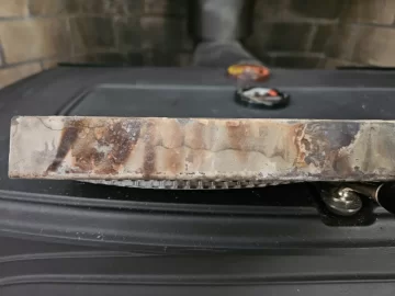

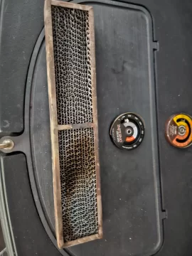

Looks like a head on collision! Here's my metal cat after hitting 1740 last January. Only a small bulge out the bottom. I had a bunch into the 1600s before that with no issues to the cat. I ran it for the rest of the winter as well.

That is worse than I have ever seen from mine, ceramic or metal. Typically my metal ones look like the pics posted by @dmccoole.
