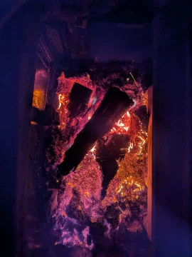

Yesterdays burn was great. Sat with the wife for a while. Cat poped up to 1200 STT was 475. Burned for 9 hours on super low

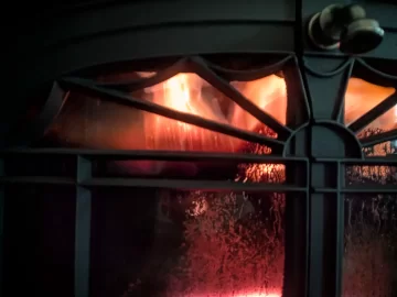

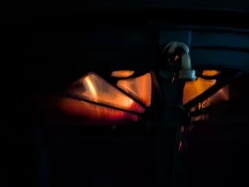

Got the stove going.. STT is anywhere between 330/369 with a cat temperature of 1290
And the house is not overheating

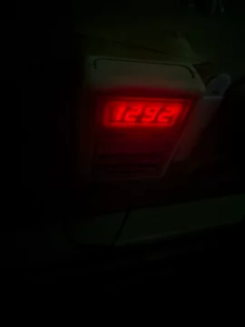

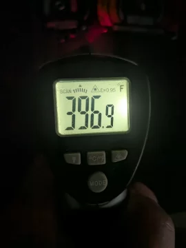

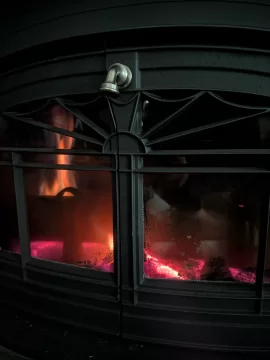

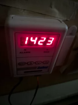

So I got the stove going. It's not running super ultra mega low, but low low. I have like 3 large splits in it. STT is under 400 and cat spiked to around 1423. It hung there for a few minutes and now down to 1333 with a ton of secondary burns in the box. This will last a few minutes and it will settle down. As I'm typing the the cats already down to 1312. The STT will pop up some with all the action in the box but will go back to under 400
My glass is still a little dirty form last night's burn but I can still see and enjoy. I'll probably burn it better with the next fire or if I let the stove really cool down

I don’t get it? You VC guys have high cat temps with low stove top temps. Where is all that heat going, up the flue?
What's up Todd, I'm pretty sure you also have a cat stove to. There are some differences in the stove we burn. All of the principles are the same.
A BK stove will burn say 20 hours with the stove on low setting. The stove itself isn't putting out much heat. The smoke created is burned by the combustor keeping draft up. Also the combustor is running at a high temperature over 1k degrees.
The difference being the the BK stove has it combustor at the top of the stove and the VC hast it's combustor in the back and near the bottom. This is why it's called a down draft stove.
This design has its advantages and of course disadvantages. The advantage in this situation is that where the combustor is place it actually heats up the back of the stove creating additional heat. This heat created heads the back of the stove. The heat created heats the lower back, sides then goes up the back, heats the flue collar area and the damper housing then up the stovepipe it goes. Although the reading of a 1400 degree cst temp is taken that normally doesn't last long. Most times the cat runs around 1000/1250 and hovers there for hours. Also by the time the heat gets to the stove pipe it's cooled the outer part of my stovepipe reading roughly 400 degrees
This is the beauty of a catalytic stove. To burn low and slow
Tube stoves burn the smoke inside the firebox this is why you get the massive temperature swings with that design

Ok that’s what I was thinking, must be the back side taking all the heat. I suppose it would be beneficial to have a rear heat shield and blower in this design. 400 external stack temp seems a little high to me? My Fireview runs 400-500 internal flue temps.
My 2040 cat-c has a heat shield on the back that deflects towards the room. My stove pipe meter stays around 350 on my single walled 6 inch pipe when at cruising temps. I confirm my temps with an IR gun too.
I had exactly the same thought about stove top temps versus cat temps at first. It’s not that the stove itself is cold as it certainly radiates heat but the amount of heat coming from the back of the stove and up around the flue collar is significant when it’s running properly.
The 400 degrees stac temp is on the top portion of the oval adapter so it's single watt there. So that would be pretty much exact temp.
The heat shield allows for convective heat and so the heat travels through the room/house
Even though the STT isn't very high it's still putting out well. Yesterday with the way I ran the stove my house was still 70 degrees inside so it's a double 👍👍 for output and length of burn
