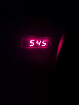

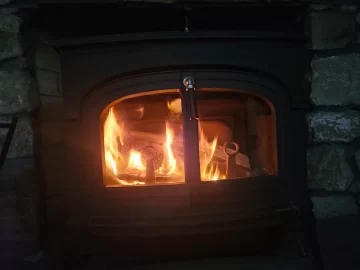

Had a small fire last night. Small amount of wood, got the cat to 1060. Wife and I just say there and enjoyed

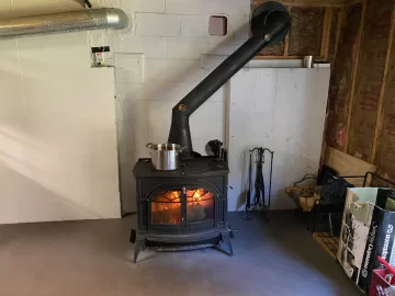

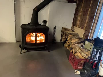

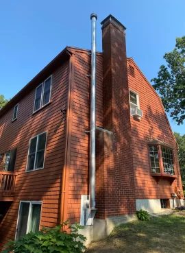

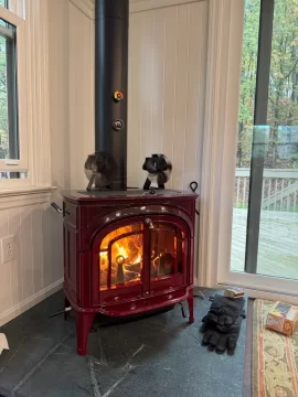

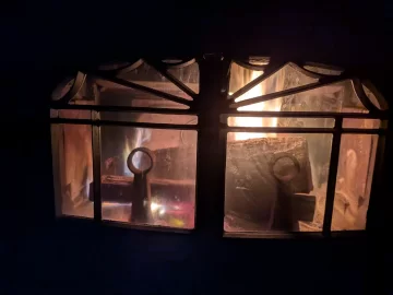

Here are some pictures of my set up. I’m sure there will be questions as to why I have a class A directly aside of a 3 flue masonry chimney. 1 is for our oil burner, 1 to an open fireplace on the 1st floor (someday will put an insert in), and 1 to the basement. And since I’ve ultimately come to peace with it and I’ll leave it simply…ultimately hired the WRONG company to do my initial install. Our basement flue became unusable and I had really no choice but to put the Class A on in order to have the basement stove without spending a boat load more money. Had to hire a 2nd company for that and I wish I would have hired them first. You live and you learn.
But yeah, like I said I’ve lived with this stove and in my opinion the Defiant is actually a great heater. I just wouldn’t go to bed after loading it or leave the house unless it’s in a coaling stage. Chimney is a 6 inch diameter flue. I’ve never measured my draft but I suspect it’s a strong breather. I toyed around with the idea of a key damper but haven’t wanted to introduce another variable as I think I know how to run the stove under current conditions. We’ve definitely cut our oil bill in half with this stove, but I don’t see myself rebuilding it when that time comes and would rather spend that money on a substitute.
Your comment about not leaving the house or going to bed after loading is heart breakingly true. The reason I spent the extra money for the bigger stove (Defiant) was the capacity, but I do not have the confidence to load 'er up and walk away. I love burning wood, I love the heat, I love the general ambiance.
