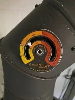

Welcome neighbor. Have you verified the STT with the IR to be sure that thermometer is accurate?
Other than that, have you checked all the gaskets to be sure they're not pulling in air? You can use incense or something a little smokey to see if it pulls into the stove around the gaskets.

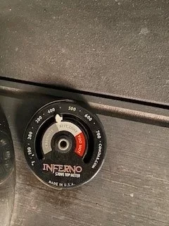

go Pats! Yeah the IR and magnet are close. I have replaced front door, ash pan, and griddle gaskets. Also had to adjust front doors, they were super leaky.
STT - a magnetic inferno from Condar on the back of the griddle. I also have a cheap infrared that I don’t use much.
Normal cat temp runs anywhere between 900-1400. I like trying to keep it in the 1100-1300 range. Highest cat temp I’ve seen is like 1650 when I’ve gotten brave and packed the stove or while the cat was new and hyper.
With a cat temp in the 1100-1300 range I have a STT running 500. No smoke out of chimney. I have a magnetic chimguard 18 inches up at a 45 elbow, running around 275-300.
It sounds all decent, but this is like a 3-5 hour burn cycle…maybe 7-8 if conditions are absolutely perfect.
Do you know why your stove backpuffs what the cause is.
Most of what your saying looks to be correct. I'd double check your magnetic thermometer many are really off. 900 sounds super high.
Just to make sure . When your stove backpuffs all your doing it turning up the he primary air.. correct
900 is my cat..not stove top. That would be enough to never burn wood again 😂🤣
Yes, when I see or smell a backpuff, I’m opening primary air. My assumption on a backpuff is a build up of gasses not exhausting that ignite. They are kind of cool to see. But campfire smell in the house.

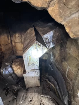

Just finished the upgrade from custom adapter (previous owner built)/13” clay tile to 6” stainless flex insulated and what a difference! 3’ horizontal out back of stove then up 13’ to chimney cap. Been trying to make the stove puke the last 2 loads and it apparently has enough draft to keep it sucked up the pipe. I’m the old setup it’d puke just cause I looked at it.

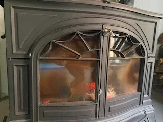

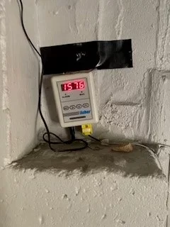

Cat temp was about 925 around 12pm and I loaded my Defiant about as full as I probably ever have, all at least 3 years old red oak. Cat temp jumped up pretty quick and at about 1250 I cut all primary air. My heart started to beat a bit faster as that first Auber alarm went off at 1450, but I decided to follow Woodsplitter's advice and not touch it. Cat jumped up to 1576 but hung there a long time. Stack temp measured via the Chimgard about 18 inches up from stove is running at 300. STT measured by that Condar Inferno is about 425. Stove glass is a mess, but that doesn't really bother me. Watching a pretty spectacular secondary "northern lights" thing going on inside the box. No back puffs.
As I wrote this last paragraph, Cat has dropped to 1513 and I think is on the downswing. STT has increased a little to 475. Exhaust still hanging at 300.
Wish me luck, say a prayer, do a cartwheel if you can, whatever it takes. I'll report back on how long until my next reload, which I think I'll plan to do around a Cat temp of 850-950. Stove is in the basement, which the temp has to be like 75-80 down here. 1st floor above is at 70 degrees. 2nd floor above that is at 65.

nice! I don’t bat an eye at 1450 CAT temps anymore; I start I pay attention above 1550.
