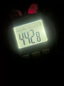

Today's burn has me scratching my head a bit and I'm not sure if I should be or not...
Stove was cold this past Saturday and I did a minimal clean and checked the catalyst, looked totally normal. I left the ash pan full and some on the top grate but took a few scoops. I relit the stove Sunday morning and it's been burning unremarkably since then. These temps are what I would call "normal" lately for my operation which is why I say unremarkably ..... normal cat temps (1000-1350), normal STT (450-500), normal stack temps (250-350). The picture is from this morning around 6am, after loading up last night around 9:30pm. Still not enough heat in the morning to keep the stove top thermal fan running, but I've been celebrating these wins. And getting back up to temp is easier.
Cat temps today though have been way lower than what I would expect. It's a rainy dreary day here outside. There is a HUGE coal base in my stove right now, like 4 or 5 inches. And I just loaded 5 medium sized oak splits. 30 minutes after loading my Cat was only sitting at 800 at full air, STT was at 500. To experiment, I closed the air down completely and my Cat finally took off, but only to 1020 where it's just kind of hanging out over the last 30 minutes. There is very little going on in the box and the stove top is at 450. This may seem weird to say, but it feels like the stove is pushing some serious convection heat.
Based off previous experiences, I would expect to see the Cat higher - like 1200-1400 . Based on what is in the box.

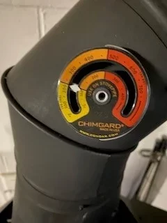

I guess my only concern with this entire thing, and why I'm scratching my head, is that my stack temp (measured 18 inches above the stove with a magnetic gauge) is only at like 225. See 2nd picture....this seems low to me in comparison to what I've typically been seeing.
My plan this week was to burn the stove until Thursday morning and let it go out as I have to go into the city for work. Then on Friday, do a little house keeping, visually inspect the chimney, etc. before relighting.
Any thoughts on that external stack temp?
EDIT: About 30 minutes after posting this, my Cat temp rose to 1150 gradually across that 30 minutes. But that stack temp didn't really increase.

Do you have an IR gun that’s reliable @Smokey Da Bears? I’m curious if your bimetal gauge is off or perhaps it’s the placement. I assume you have your stove pipe gauge where it is to make it easier to read. I wonder if moving it to the top of the bend would make it read a bit warmer.
My guess is that at 1200 cat temp, your stove pipe temp is warmer than that meter is showing you.
Right now my cat temp is 1186, stove pipe is ~350, stove top is 480. My stove top temp always rises in the later stage of the burn and I would agree with your previous statement above convective heat when it comes to this later stage.
Reactions: Burnin Since 1991
I actually have 2 bimetal gauges on my black pipe. The one in the pictures is about 18 inches up right at a 45 after the oval to round . The other one is about 30 inches past that prior to a 90 where I then meet up with a thimble to go out the house. I find the 2nd one to run hotter by about 50 degrees, and I've never "fully" trusted that one, mostly because it's a cheap Amazon thing that I probably should have threw away 3 years ago. Yesterday they were both on the lower side and correlated (+/- 50 degrees). I do have an IR gun that I often forget I have. I'll pull that out and give it a look.

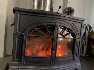

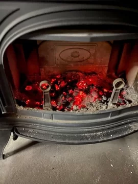

I had a nice insulated bed of coals this morning from a 7pm load up last night. Cat temp was only 180, stove top about 150. Warm to the touch but not throwing any significant heat. Stove is in our basement with a central staircase, we leave the door open and run a small fan pointing back down the stairs. 1st floor was 72 last night when I went to bed. It was 67 at 5am this morning. It's a lot colder out this morning, high 20s/low 30s. Restart was very easy with a sheet of paper, sticks, and some small pieces. Added some small to medium splits and burning those down now before loading up and getting off and running.
Hope to have similar results today and into tomorrow morning, but sadly need to go in to the city tomorrow for work. So the stove will go cold tomorrow. Looks like we'll see some cold outside temps in the 10-20 degree range over the next week.

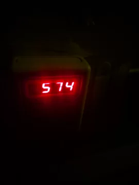

22 degrees this morning when I woke up. House super comfortable. I loaded the stove last night a little before,7 pm. At 5.30 am my cat temperature was still in the active range at 562 and had a ton of coals going on. Definitely had more then another hour or so of actual good heat from this burn.
The box was loaded with thick split oak

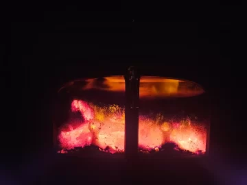

Stove is relit after a commute to the city yesterday and we're all happy again. The oil heat just isn't the same - granted I only set it to 64. When I got home last evening everybody had a few extra layers on 😂🤣. Took a while to get that coal base built again but we're cruising and 1st floor temp is 70 again. Cat popped up to 1320 on this load of maple. The smell of that is pretty pleasant in comparison to Oak, it's got a sweetness to it.
  • [Hearth.com] 2025/26 VC performance discussion thread

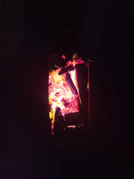

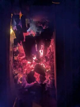

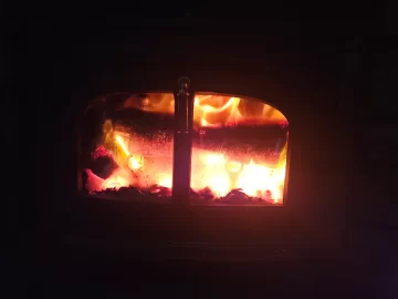

Tonight’s reload, 1 piece of ash, 3 large mystery heavy/stringy splits, and 1 small piece of maple to fill the right side gap.
Let’s see how she burns overnight:
When I walked away the cat still hadn’t crossed 1000, but it was starting to off gas, I’m guessing it’ll creep up over the next hr or 2. Air is just a crack past full-closed.

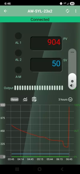

What cat temp monitoring app/sensor are you using?
I'm using Auber's AW-TMB-Deluxe wifi control box with Auber's AuberWifi(V2.5.1) app on my Android. I wish the app gave more than 3 hours of history but it's really nice to be able to monitor the temp from anywhere.
