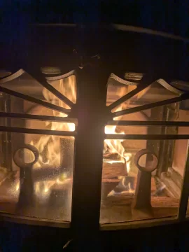

So I did my.first fire last night
It was so satisfying. My wife, daughter and myself sat there and just hung out on beanbag chairs
It's been way to long
Stove performance was excellent considering the outside temperature was the low 60s
