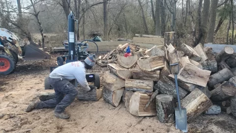

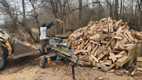

I process my own wood so I split my wood just for this stove. I cut my wood 18/19"long. All of my wood. As I process my wood, some wood is for day burning and some is for overnight.
The larger rounds like 20"round and up normal get split for overnight while the smaller diameter stuff just gets quartered for during the day. The stuff we burn during the day is just your average triangle looking pieces, limb wood ect
Overnight wood is split differently. This wood is split in squares and rectangle. I use all the Heartwood and it's super dense. I burn all oak for overnight red, white, pin. I scrounge all my own wood so I can be picky.
Before bed I load the stove to the gills. It's like a Jenga puzzle in there. I basically form a large hunk of wood in the stove with no space in-between. I'm pretty sure I can get at least 50lbs of wood in there. There is room on the sides and just enough space to shut the griddle.
