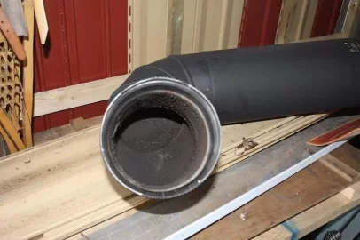

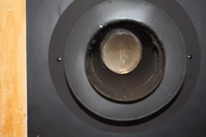

Just did my first check after my new PE Vista install .
Stove was put in on Dec 13.
It was really windy out so I just did a quick sweep bottom up even though there was almost nothing to sweep on the outside.
A little more in the flue,but that is due to the 90 and 45 elbows to the thimble .
I figure maybe a coffee mug full of soft brown residue for the whole system , pretty good I think .
I'll check again in another month .
What say ye ?
Pics of the thimble and fluepipe ends . [Hearth.com] 35 days in...Chimney inspec . [Hearth.com] 35 days in...Chimney inspec . [Hearth.com] 35 days in...Chimney inspec .
I see no black hard shiny stuff or for that matter no dry chunky creosote.
Looks good from here!
Looks good , check it again at the end of the season unless the temps , outside get unusually warm .
