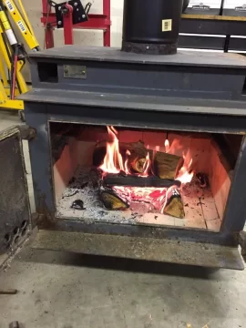

Bricks right up to within an inch (less) of the secondary manifold and roof.
I saw one row of bricks in there, I figured there would be some sides above that in a 3 cu.ft. box...there's quite a bit above the bricks in the mighty Buck, and that's like 2.8 cu.ft.

Maybe he's been in your stove stealing your bricks!
Yeah that way he can make more efficient;em his keystone:p
Whaddya mean? My Keystone is already one big soapstone brick....two thick! ;lol
