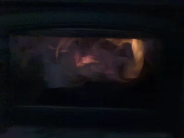

A nice full stove.
settled back to 745 °F

9:10 Stove top 450, stack 560. Fire "evolves" to "top-down" fire, buttom no longer flaming, top pieces burning briskly, very active secondaries. Observe EBT still closed.
9:15 stove top 550, stack still 560
9:18 First pic taken.

10:05 a couple more pics:
  • [Hearth.com] A nice full stove.
