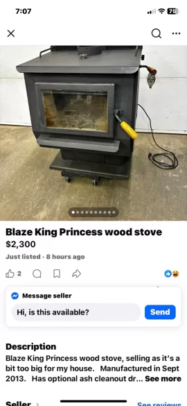

Wow too bad this wasn’t listed before I paid for mine. $1613 USD woodstock N.B.

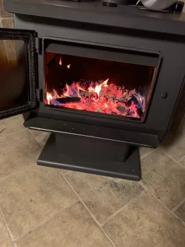

First fire :D

I think I could have charred a bit better. I saw one spot that was still bare wood. That said been running 12 hours and only burned little over half the load. Still going good. crazy!
Edit: just remembered when I loaded it yesterday, closer to 14 hours ago!
