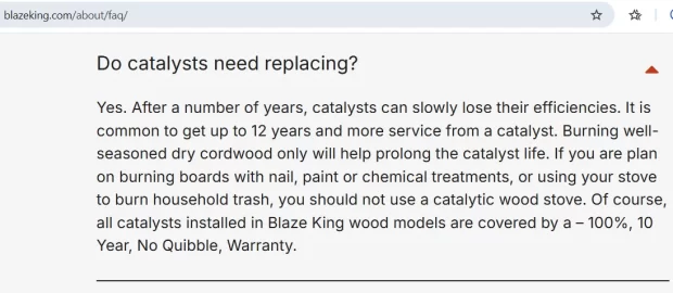

I talked to the dealer today. They assured me that I would should get 9 years life out of the cats burning a couple of cords per year. She sent me an email with this doc.
She was nice and she believes what she was told.
I’m more inclined to believe the real world experience I have read on this forum.
I attached what she sent. I noticed the qualifying words ‘up to 3 cords’ in the doc.
Yeah, I don't buy that.
It's *not* common to have a working cat for 12 years, as they state in the second part. Not here, at least.
Maybe some folks leave the cat in for that long - but maybe they should have replaced it much sooner.
I burn 2 cords a year. I started spring 2020 with only a few burns, so first full winter was '20-'21. So upcoming winter will be my 7th with this original cat.
I think its efficiency is decreasing, so I'm going to keep an attentive watch to my chimney exhaust, and to the temperature behavior. We'll see.
I know BKVP mentions these timeframes, but I just have not seen folks here with that experience. And I note that BK folks are notoriously (justifiably >> ) braggadocious about their stove performance, so folks running that long would likely have jumped in and told all of us about it.
Maybe there really a few. But the majority here won't reach that.
Nevertheless, 4 years or so is fine, with me, for the performance it provides.
Though not for $1000 per 4 years...
