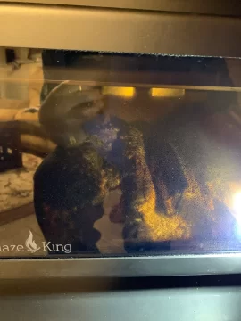

I actually came on here to ask people’s advice about my current load. Wood is charred black and smoke is rising off it. Do tou guys think I should open air up a little, close it down or am I in the sweet spot? Fire been cruising like this for 3 hours so far.

If your chimney is not showing smoke outside, and your room temperature is what you like, then all is good - for the next 24 hrs or so :-)
That's really all that matters. That's how easy this stove is.

I think I see a little smoke. Could be just steam IDK.
Edit: I’ll let it roll the small wisps of “smoke” ai saw outside are gone now maybe it was the thermostat adjusting to with temp.
Yes, it could be some initial smoke, if the cat was not yet up to speed with the (large) amount of fuel you're feeding it.
Sometimes with my now older cat, if I dial down too quickly, I see a lot of smoke in the firebox like in your video, and then it sometimes is more than the cat can stomach. It overwhelms it. Then I see quite some smoke out of the chimney. (I.e. if I dial down slower, I do see less smoke; I think the "much smoke" case may mean the wood was not charred enough - but that's a personal conclusion that others may disagree with.)
This is also noticeable by the cat not increasing in temperature (as read by the cat gauge) - when dialing down to a lot of fuel, the cat gauge temp indication should increase. If it does not, one might be overwhelming the cat (leading to coating of it with soot, blocking the catalytic particles from doing their work.)
At that point I have to open the air what to get flame, and then dial down more slowly. That always works.
But with a new cat that (overwhelming the cat) is not likely to happen.
But it's always good to look at the chimney say 15 minutes after you've dialed down to cruise setting. Especially if your cat gauge is not going up when you dial down. And if you see smoke, add more air, let it burn vigorously for 5 more minutes, and then dial down a bit slower than you had done initially.
That's my operational mode.
Others may have different ways of doing things.

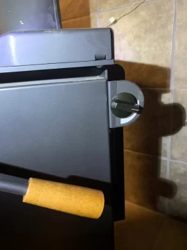

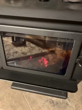

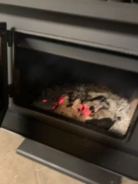

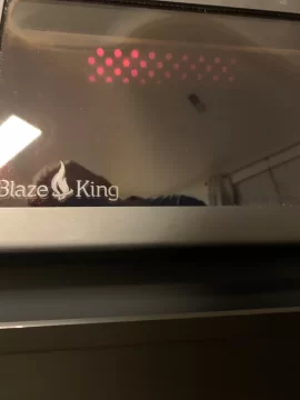

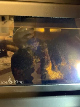

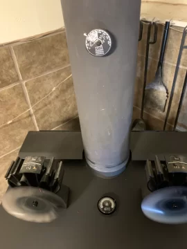

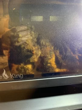

Here’s some pics, as video may not work.
Not gonna shut it down as much on this load.
Aiming for less creo on glass. Wood started out just blackened.

That aligns pretty much with what I have been thinking. I’m probably overthinking it :D.
I noticed the thermostat works real good automatically keeping the cat in the sweet spot.
Earlier video worked here.
Creo on the glass is fine. It happens all the time.
I just noticed that I get a bit less smoke in the box if I dial down a bit slower.
But as long as the chimney doesn't shows smoke, all is good l.
The thermostat is not meant to keep the cat temp constant. It's meant to keep the heat output constant. That output consists of cat output and firebox output.
Looks like the sweet spot SteveB, I always get a kick out of looking in and seeing the log burn like a cigar and somehow it’s satisfying the cat enough to keep it well into the active zone.

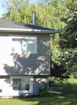

How tall is your flue?
If that first burn was with a fully loaded stove, 24 hrs is a bit meager if the thermostat was at the lowest setting.
Interesting.
Edit: The one burn I loaded after 24 hours, probably would have gone 26-27 if I had left it (there was a lot of coals).
I don’t know for sure, guessing about 17’ ’.
Stove in basement.
This is google street view.
