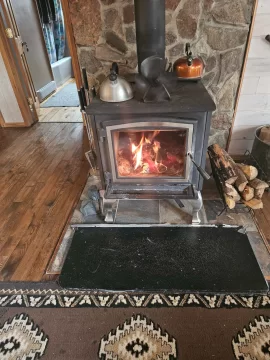

I have the osburn 3300 but sadly they do not make it anymore,that said with a 3.3 firebox I get 9 hours on pine.
  • [Hearth.com] Seeking advice on new stove BK Soricco vs HT3000
Yeah it’s a shame they don’t as well as it seems the big pacific energy stoves aren’t the same the fireboxes are smaller it seems as they are listed now at 2.5 cuft versus the 3 they used to be I’m guessing due to updates to meet the epa standards
I was looking at trading my 3300 at my dealer for the pe summit but noticed that about the size being smaller,I live in a drafty old cottage so I like a stove with a big belly

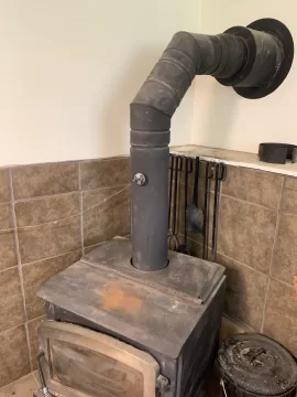

I did the inside double wall pipe myself about 18 years ago. The whole way down the inner crimped end is inside the top of the next piece.
Do any of you see any issues with the pipe in this pic?
Screws holding the elbows to the pipe?

I just removed those screws. Plan on cleaning.
