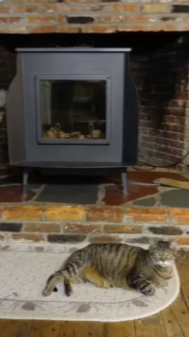

Woodstock said it was OK to remove the artwork, to see how we liked its look (just held on by screws). Wife and daughters think it is too plain...

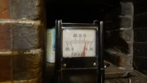

We have a strong draft. How strong? Woodstock is letting me borrow this meter. A typical draft is in the -0.05 to -0.07 inches of water column range, and at 35 degrees outside we are running considerably stronger.

Looks like a steel fireview with fins.

I could get one like that, then have my SIL "faux" it to look like brick, or a cob oven.....or even soapstone! ==c

Was that a low fire? What happens with a high fire? _g Your damper tames it back down to about normal, though?

About the only similarity I see between the two stoves is that they are both taller than they are wide. Oh, and they both have a window, and legs. ;lol

The fire was medium-low. Later in the evening, on a higher burn, it was holding stead at -0.20 inches, and the key damper took it back down to -0.10.
These key dampers aren't like some I grew up with, in that this has more holes and doesn't scrape the sides of the pipe as you turn it.

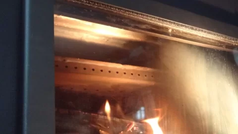

Here's the front edge of the fireback, with the holes for the third air supply (the glass is cleaner than it appears - I have a flashlight shining at an angle). The air introduced here with flame right there if very hot, or will feed the cat's combustion; either way is good. There is a fresh load in the firebox, so very little flame to see. STT is just over 400, stove front is 450, flue temp is closer to 500 (key damper fully closed).

The draft has been running at -0.20 most of the day when the key damper is open. We have -0.05 with the stove door open and key damper open.

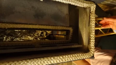

The bypass on this stove is more similar to the PH than the IS (a simple flapper, as opposed to the IS sled). I appreciate the simplicity of this design. The handle and the bypass flapper are all one unit (no linkages, etc).

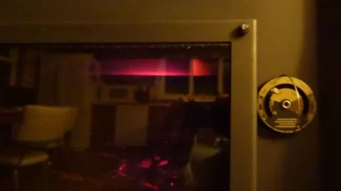

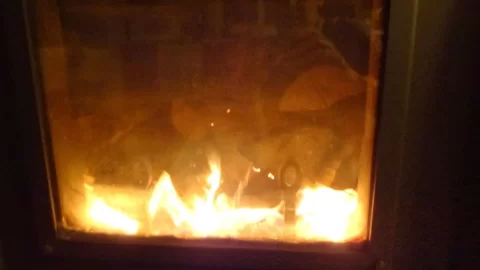

Glowing scoop around the cat (and a bunch of reflections!). Stove-top at 600. Air is fully closed, key-damper is fully closed.

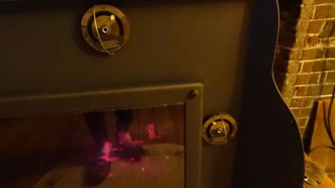

Another shot to show where the heat is. I can hold my hand within half an inch of the glass for extended periods of time because all the heat is up above, at the cat.
