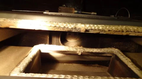

We have a key damper that is built into the Tee (I'm not sure which type). In the pic below, the cat and its heat shield are removed and you can see into the rear exiting stovepipe to where the damper is closed.
[Hearth.com] Absolute Steel Hybrid
I've read there are other ways to measure draft but haven't tried any. The general notion is the amount of suction, measured in units of inches of water column (negative inches). This Tee has a hole drilled into it, and we insert a metal tube into the hole (about 1/4" tube). The metal tube has a rubber hose attached that leads to the meter. I think the other methods involve an actual tube of water (as I'm sure the original tools did) - this has an easy-to-read scale that can be zeroed out, and no water.

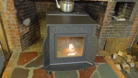

The top lid of the stove has a front lip that bends downward; that lip had very tight clearances on the early beta version we started with. If you weren't careful, it did not fully seat onto the gasket. We have the revised top to try - the top extends out another half inch or so, and the lip has a slightly different angle to it. Plenty of clearance now. My wife wanted to try it as simple as possible, and we are both liking this look. We intend to buy one, and I suspect this is the look she will select.
