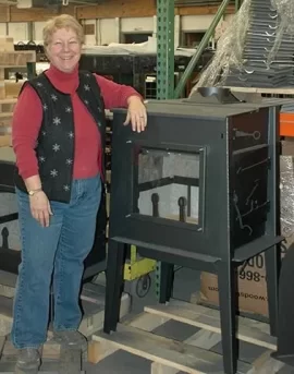

I could go for the long legs beats bending over. What's the shaker is it the metal wings?

I found this on their blog (broken link removed to http://woodstove.com/custom-color-stove-gallery/38-stoves) (scroll to the bottom) and asked the company about it. I guess it's supposed to come out in the spring/summer. The text that was with this pic (from memory) said this lady is 5'2" and this was a beta long legged shaker. I assume it would come with or without the wings like the rest of the ASH. Another link
