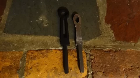

When we first got this stove I thought the andirons were a bit short. As we've burned it more, I've realized that it hasn't been a problem (the wood is longer then the window is wide, and we don't get wood against the glass). In the meantime, Woodstock made up some taller andirons for us to try - these are about 1" taller and a little wider. They simply drop into a pocket, so easy to remove for cleaning the glass (which PH owners will appreciate). Yes, the glass does need cleaning...

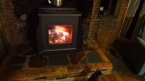

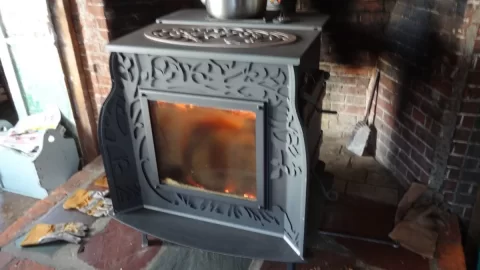

My wife was lukewarm about the original artwork, so Lorin asked for it back and gave it a paint job. This version is getting high wife-approval ratings.

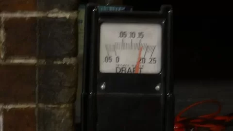

Also, as one who generally reports lower burn times due to our need for heat, I should note that this fire was restarted from coals 20hrs after the last reload, and the draft was left wide open the last 8 hours of that time. I personally would not call this a 20hr burn, but she will go the distance even while trying to get rid of the coals (we replaced the glass frame with a different style, so needed it cooled down).
I also checked the cat, and did not bother to clean it. On this same setup with the PH or IS I would have needed to vacuum it by now (close to half a cord). I think having the key damper installed (and fully closed!) is making a big difference.
Here's a pic from tonight with the draft fully closed both on the key damper in the flue and on the stove's air control. A "normal" draft is 0.05 to 0.07 (tonight's specifics for this pic are 2 F outside and no wind, 440 degree stove-top.)

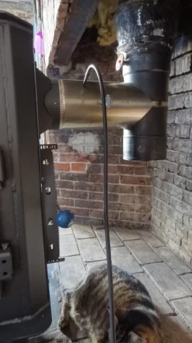

Yes,6", internal chimney, about 32', insulation wrapped around the liner. We sit out in the open (not much for trees or hills to affect the draft).
Where did you put the damper? I could use one but wasn't sure if I could with a flexible liner, I guess I could put it near the top of the tee.
It is in the horizontal part of the tee. (the rubber hose is for the draft meter, the handle for the key damper is just to the right of the rubber hose)

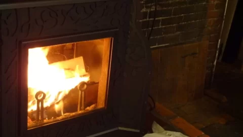

Intentionally burning some 10mo CSS Sugar Maple just to see how cleanly it burns. It is slow to take off, but is burning better than I expected (no MM readings, yet). Not liking what it does to the glass. This is at startup, with the air wide-open.

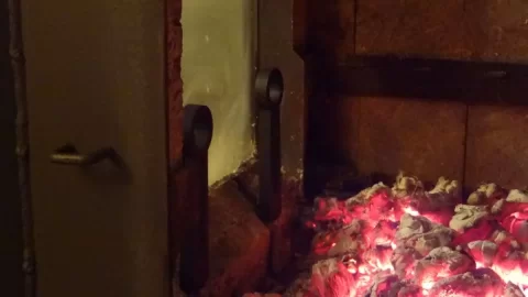

At least it burns off nicely...
