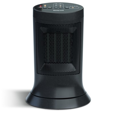

Our bathroom has heat, but it's a large bathroom with a skylight. We just have a little ceramic space heater from Target for when we shower. It's only on for a few minutes a day.

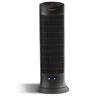

My wife has been working from home several days a week. Bought a tower version of the same thing for the upstairs bedroom that has her work computer set-up. She'll run it for a few minutes a couple of times a day.
I thought about Honeywell or Lasko, but that's too bulky for a bathroom. I liked ceiling models like Broan-Nutone from here. was hoping someone could share his experience. Thanks, anyway
