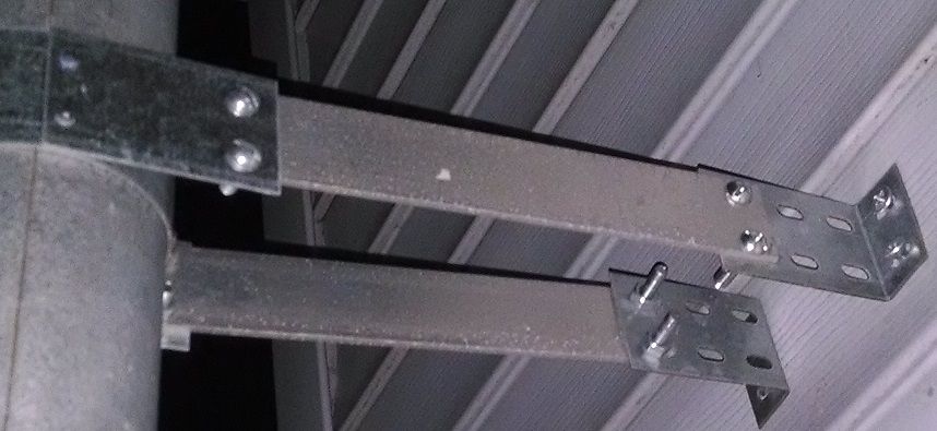

I have a similar problem. the adjustable bracket shown above ((broken link removed to http://www.woodlanddirect.com/PelletVent-Pro-Adjustable-Wall-Strap_2?gclid=COrOrMffkrwCFclQOgodsikAJg?gdftrk=gdfV23673_a_7c1677_a_7c8224_a_7c2591790_a2s__a3a__a2s_2591791#259Diameter%3A3%22)) only provides 1-3 inches of clearance. What if I need to go beyond 3 inches of clearance...let's say 4-5 in? is there a product out there for that? Or would I need to cut/trim a vent pipes to get to the perfect length?
You can easily add a piece of aluminum between the two pieces of the bracket. Two cuts with a dremel and four drilled holes for the bolts on each side and you will be good to go. Probably five dollars at home depot or Lowes. I will try to take a picture of how I did mine later.
Reactions: PennPellet
Thanks, a picture would be great.
Here is what I did. Just cut a piece of aluminum to size for each side and then drilled holes to attach the bolts. Takes maybe ten minutes if you have a dremel (doesn't everybody who has a pellet stove?).

I just put a piece of red cedar 2x4 against my siding and screwed into that to give myself a little more clearance.
[Hearth.com] Adjustable vent bracket/standoff?
Excellent, that's exactly what i wanted to see. Thanks for the help!
