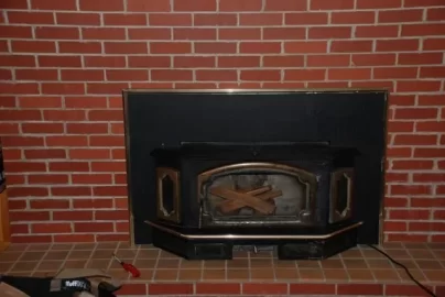

Tick- just for some perspective we just put in a lopi freedom bay that's about 5 yrs old; it's in good condition and I paid about $900; so the price for that insert you're looking at sounds pretty good. Just got ours installed yesterday and I'm already amazed; works like a charm- yes it has a blower but it seems to do pretty good even if the blower is off. I was happy to wake up to hot coals this morning and just tossed in some new wood and it fired right up.

Tick- in terms of install I paid a couple hundred bucks which included picking up the unit at the sellers house and hauling the #500 monster down a steep flight of basement stairs. Here's a pic- everything here came with the stove except the wood inside it. Since it's a slammer there really wasn't much to the install except the brute force required to move it.

Like your "bay" especially because it looks like it is a little more like a hearth heater, so it would probably do pretty well even without the blowers? Well, better than other inserts, anyway.
