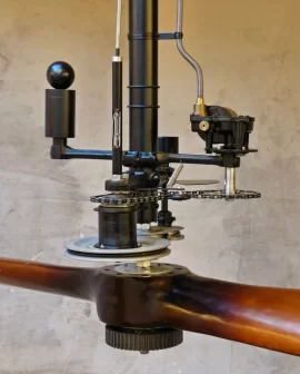

On the ceiling fan, yes... it will be enormously helpful with your 25 foot ceiling height. I haven’t seen any photos, but just going from my mental image of exposed-beam 1880s construction open from ground floor to attic, I’d be looking at something steam punk, Victorian industrial.
Okay, doesn't the engineer in you rebel at the very sight of the big gear at the bottom that isn't connected to anything? Right next to the foot of bicycle chain doing the job the gear SHOULD be doing? ;lol
Lol... yes. ;lol But I was in a rush, and it was the first photo I found on google that conveyed the aesthetic I was describing.
The engineer part wants the repurposed variable pitch airplane prop that he can change pitch on at will. Connected to a remote control...
Reactions: Ashful
