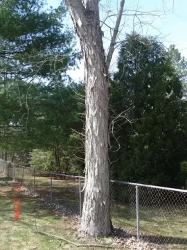

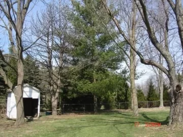

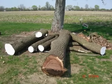

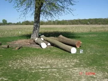

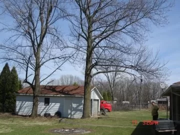

Here is what I will be milling
hickory,The one in the 2nd pic on the right is tulip and the 3rd is a walnut far left
