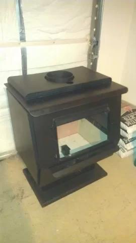

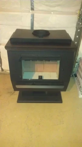

    Look what I got today :). Holy man am I ever excited.
    So, I am going to have to go get the chimney this weekend, and, decided that I am going to have to do the install myself. Instead of having professionals do it in one day, it will probably take me a week, but, I will be saving $800.
    The reason I am having to do it myself is, I have two dealers getting me quotes, both are to include install. One has taken nearly a week to get back to me, the other said he would get back to me within 24 hours. That was on Saturday. So, if they can't get back to me in a timely manner, are they really that reliable?
    So, a word of warning. Be prepared for a barrage of install questions.
    Actually, it shouldn't be too bad. Going through one wall, then straight up through one attic and one roof eave.
    It will probably be another two weeks before I get to get started on it though, so, I get to just look at it out in the garage until I get to bring it in.

    Congrats.
    So, $2200? That rocks. I paid $2450 for mine here in Michigan, but it sat in a showroom for five years, and they really wanted it gone.
    You can always push it outside, shove a piece of pipe in it, and light a few fires. It will help to burn the paint in and keep some stink out of the house.
