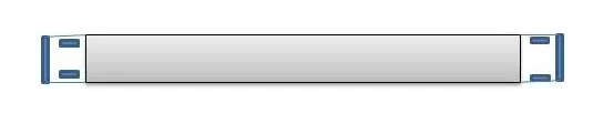

    You do not NEED to buy the brackets, either. I pre-drilled the 2x4s where they meet on the bottom and joined them with (2) 1/4-20 4" carriage bolts. Ives tried both the Stack-n-Store and bolts and nuts /w washers - and I think the bolts are stronger (and cheaper). I have had some of the welds break on the Stack-n-Store brackets,too.

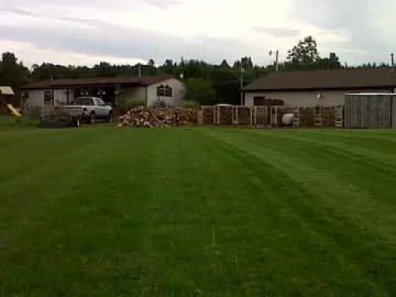

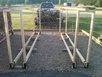

  17. DexterDay
    DexterDay
    Guest 2.
    Mine are 4.5 ft tall x 12 ft long. The reason for the 2x4 at the top, is I am going to put 26" sheets of left over steel from my barn and cover (longways 12ft). Also have a little shed. Holds a little over 3 Cord over a Cord.
    I used Rutlands Stack-n-Store brackets. Just add 2x4's..
