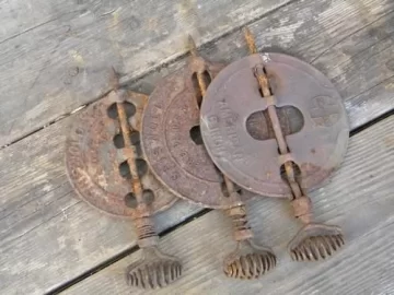

You are right SemiPro. This is an incorrect statement. Key dampers are slotted so that they can not block off all the flue gases. They are commonly used to reduce strong draft. In our old setup with the F602 the key damper was always closed fully once the stove got going. Ran the stove for 10 yrs that way and never had the CO detector make a peep.

I did not say to not use a damper, I said one should not fully close a damper during normal operations. Reducing flow to the chimney using a damper because the draft is too strong should be an occasional issue only (such as during high winds). If you have to use a damper all the time, or fully close it, then your chimney and stove are then most likely not correctly matched and that should be properly corrected.
Why a damper during high winds?
A flue damper is great way to address over drafting. How else would one address the issue? In many cases high drafts are caused by tall chimneys. Are you suggesting that there's a better way to address that then with a damper?

dampers... are commonly used to reduce strong draft.
Which is what I said. But strong drafts should not be constant. Else it is a more fundamental chimney problem.
Modern stoves, with modern chimneys that match the stoves specs do not need much damping. I built two new chimneys, have not had to do any damping when running my stoves to spec.
