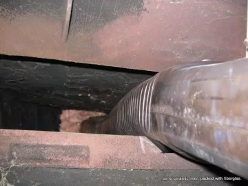

The first is a shot of the incredible creosote build up before I cleaned it . You can see how it is hanging on in big
lumps and constricting the opening of the flue. I have never seen anything like this.
Then you can see the pile of creosote on the ground after removing from the chimney.
Then you can see the chimney after I cleaned it.
Finally there is a picture of the SS flue to the ceramic liner where I have stuffed the Oval-to-square gap with fiberglass wool insulation.
This may not be the best solution but its worked for many years and doesnt burn away.
I have started burning a roaring fire once a day followed by hotter fires. In addition, I sealed up the gap between the ss and the liner.
I hope this works.
Tim

The attached is from the NFPA 2006 document section 211.
It appears that the code allows for this type of installation, with restrictions placed
upon the cross section of the SS flue vs the masonry chimney.
Yes, the SS liner, backed with a fill of insulation is the best solution for sure and I'll
be going to that next spring. But, in the interest of science and my understanding of why and how
creosote accumulates, the question remains
what has changed that caused the non-creosote producing setup to suddenly start
producing huge quantities of it.
In my mind, either
1) I have been burning the stove too cool and have not reached the critical temperature of the chimney
above which creosote accumulation is minimal and below which the rate sharply rises .
...or....
2) a small air leak or several air leaks have allowed enough air to enter the chimney
to cool it and allow a sharp rise in creosote accumulation.
It must be remembered that this setup has been used for years with minimal creosote accumulation.
