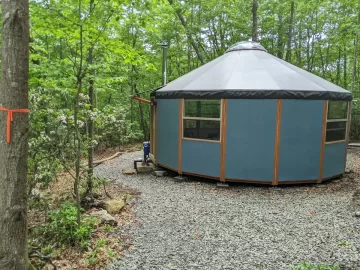

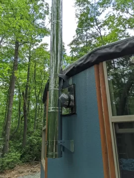

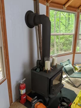

Thought I would belatedly follow up my request for information with some photos of our installation. Our Pacific Energy Vista seems to run fine and warm this place well and quickly. We didn't have a ton of time to test it this year though. I'm sad about how quickly the glass gets dirty, but am guessing we'll refine our practices to reduce it. It was mostly used by our contractor this winter and I have no idea what he was burning in it. Most of the wood on our property probably hasn't dried properly. I bought a fluegard thermometer and hopefully that may provide some information for us. In my completely inexperienced guess it's not burning hot enough or the wood is not dry enough. The recommendation on hearth.com to simply use damp newspaper with a bit of ash works amazingly well and I can't imagine needing to buy a product to improve upon it.
Where do people install their fluegard; plain sight on the front or the back to keep the plain black aesthetic? I kind of like the regular reminder mounted on the front, but can see the appeal of hiding it it. On the whole we liked our contractor and they were very responsive to a thimble water leak. Though $5K for the stove, installation and waiting most of the winter or four months for that was a hard pill to swallow. In any case I'm grateful for the help we from this community.

Yes, it's a hard sided Freedom Yurt as a vacation property. Our impression has been positive so far. The lot we're on was undeveloped sow well over a year in and we're just nearing the point of catching up on at least bucking and stacking the homesite and driveway trees. Much to split still. A garage and driveway expansion along with a septic field is coming so the number of trees on the ground will soon overwhelm us again. _g Much of the forest is younger second growth and skinny so we have not been splitting a ton.
