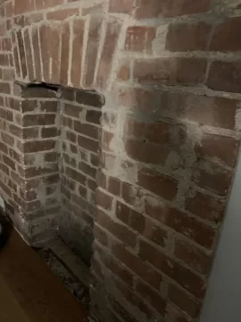

I just discovered this forum and I’m trying to educate myself but can’t find an answer to my issue.
We have a chimney that the chimney guy says will only fit a new 5” liner. He’s the chimney guy everyone recommends and he dropped something down to test measure it.
I can’t find anything that will work with 5” anywhere, except for RV/small homes which seem like a insurance liability.
It’s currently terra cotta tile lined I think and hasn’t been used for anything in probably 70 years.

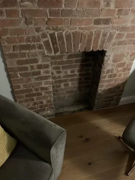

The fireplace itself I think was made for coal so it’s shallow at 8.5” deep and 23.5” wide and 32” tall.
I just want to find out if I have any options other than tearing open 3 stories of brick to widen it and get a bigger liner down there.
I’m open to ANYTHING wood burning and obviously don’t expect it to fit fully in the fire place since it is so shallow, it can stick out into the room like a free standing stove.
Here are some photos attached. Any questions feel free to ask. I’m a newbie so may have left out important info.
Thanks in advance for any advice!

What is the ID of the chimney? Did the chimney guy discuss breaking out the clay tile liners?

An older Jotul F602 will fit and that took a 5" flue collar. They came with a 5" to 6" adapter for American installs.
A 30' flue is going to pull hard, so it may be off-label, but a small firebox stove like the Morso 2B would probably work ok on the 5" flue. Check with Morso and Jotul to see if they agree and approve of any of their small stoves on a tall 5" liner.

You need more specifics and maybe another opinion. Breaking out a tile liner is not uncommon and should not be a huge expense. It is messy, and the area should be sealed off mainly so that dust does not get into the room. An oval liner may be another alternative. We need the ID of the current tile liner to provide more options.

Maybe abroad. In America, stoves have pretty much standardized on the 6" liner. That said, the 30' liner is going to draw hard so it doesn't hurt to ask companies if they would approve of the 5" liner in this case.

That was my thought, so I looked to see what would fit. Sadly, the small cast iron Hampton line has not returned. The Regency 1150 is their smallest steel and it is 1/2 too wide to nestle into the cavity. And at 32 3/16" tall it would be very hard to top vent unless a thimble was added up above the fireplace opening.
