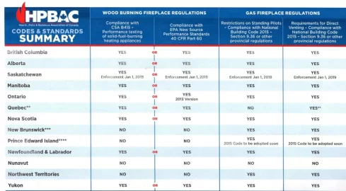

It depends what regulations you are referring toCan you tell me who sets the regulations for stoves in the US? Or is this an industry standard? Here in my part of Canada the standard is set by my city. (We just installed a Regency that is compliant with city regulations).
It is pretty much the same in the us as wellIn Canada we adopt the CSA B415 emissions standards. This CSA standard is the same as the EPA at a max of 2.5 g/hr.
Montreal just implemented the standards a year early, and required all old non EPA 2020 compliant appliances to be replaced with new versions due to poor air quality.
Most other jurisdictions in Canada have allowed all older appliance to remain in operation, just new ones must comply with the new standards.
