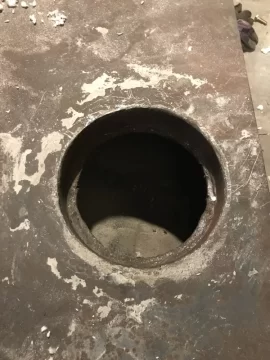

Thanks for responding! I thought it might help to send a picture of the woodstove opening.
The outside opening is actually a little shy of 7 3/4” and the inside opening is 6 3/4”
In that case you may need something custom made
Maybe install the 7" adapter with some 3/8" rope gasket packed around the adapter?

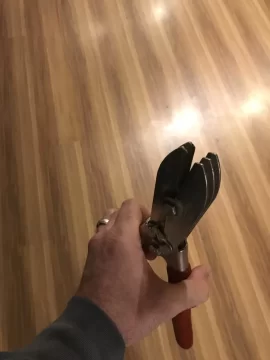

That’s an odd size. As mentioned above, some old stoves had 8” of flue collars, the pipe went over the collar. They made what’s called a skirted adaptor for this application, but most people just ran their pipe upside down. Without a flue collar that extends up above the top it wouldn’t help though. Can you just crimp the adaptor more aggressively?
Thanks for the info! Yeah actually tried to crimp it with this tool! But it didn’t effect it all that much.
