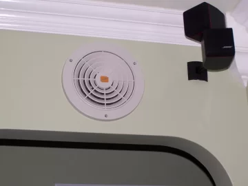

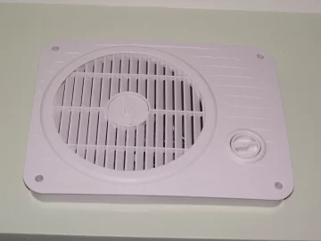

I have a ranch style house with central air ducting in the attic, I tried just using the fan but was not that impressed with the outcome. I then installed a couple of thru wall fans over the doorways, will have to wait until next winter to really test them out.
