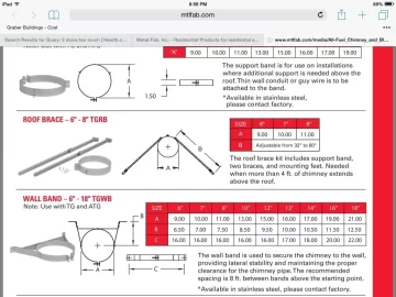

Just went out and took picture sorry for the glare, sun is on other side house now. Its 16 feet the chimney. Up top where the support bracket is for the roof if i add another piece of chimney i pretty sure the instruction only stated a certain height that the bracket supports.

There needs to be a roof bracket once for every 5 ft above where the pipe exits the roof. Is there already a roof bracket close to the cap? If so you can add another 2-3 ft. Is there a cricket (snow diverter) on the upside of the flashing? Also note that to a certain extent the front slope of the stove may be contributing to slight smoke spillage. Waiting a bit after opening the thermostat and bypass to let the smoke clear before opening the door should help.
No cricket. I also had no idea you can add another bracket above the one i have installed. Their is one roof bracket on the pipe now. Begreen they make brackets that long? The one i have now is already fully extended and back when i was looking at longer brackets from metal fab i couldnt find one on their website.

Hey begreen i posted a picture of the roof bracket i bought from metal fab max length is 60 inches. If i add another 4 feet of chimney do you know of brakcets out their that are longer? I mean i think im gonna need like a 10 foot bracket.
