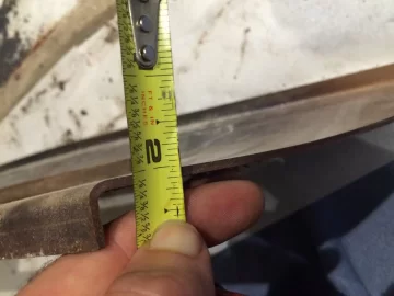

Coudn't wait until 17th when your people gonna take a look at it. "Dissasembled" mine today to get the baffle out.
Relatively easy: after removing secondary air tubes it's just falls down.
The bad news : its warped more than it looked when it was in. Need to figure out the way to make it flat again. Front runners : Driving over with heavy truck (Dont think regular car will do, It's quite beefy), or log splitter force somehow. The other option they suggested at dealer is to hammer it back to flat.
The good news : even if its not 100% flat and some gases will go around it on a sides it;s not going straight to the flue. If bypass is closed evryrthing should go trough the box where cat is. The cat seats very tight in it. It's quite sturdy and made of 3/8 steel.

Wow .Thanks for the response .So the baffle, even if warped, won't affect anything? How did you take it out? I am eagerly waiting for the guy to come over and check it out . Do you think it will affect the performance of the stove?
The baffle just laying on a tubes. Once you remove two front tubes it comes down . There is a layer of insulation between baffle and chamber for cat. It's kinda like a shelf laying on tubes. It's not air tight, you can move it a little . It's just supports insulation. It's less then 1/2 of insulation. I don't see how some warping will affect it greatly. They even have instruction in a manual how to remove the baffle, so I think it's not uncommon occurrence .
I've hammered it back to original shape, put back in and had my first fire of the season. And what do you know , After stove got back to working temp the baffle changed it's shape a little , sumular to how it was before. At this point I'm not worry about it, unless it warped real bad. And if it will, Ill just make it flat again with my hammer.

The baffle in the insert is very different than the free stander. The way the plate steel baffle warps doesn't look like too big of a deal. On the stove, the baffle is very thin stainless. It warps and curls unpredictably during the burn and then relaxes to an extent once it cools down.
