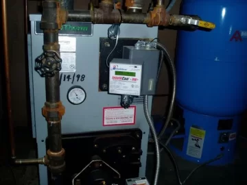

I was able to wire the intellicon HW myself with help from the seller who provided a schematic for my exact aquastat.
I used the pictures in the post to help me in my install/attach to the aquastat.

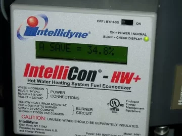

Installed it last Thursday evening and I cannot believe the savings 34%.!!! I keep good track of oil use and degree days so we'll see. I do know this, that something is going on as the area around the boiler is a lot cooler. Don't think I'm producing any unnecessary heat. I would be happy with 15 or 20% but over 30...wow

I don't think there's any way to expect 30% from an add-on control. Just no way.

Thanks. My Burnham V8 oil boiler is about 6 years old and is a cold start boiler with an indirect dhw tank. I just looked and the aquasat only goes down to 180F which of course disagrees (lower) with the temperature shown on the gauge. I'll be using that for the hot water heating (with priority) and the Tekmar for controlling the zone heating (I hope). Hopefully, the Tekmar will allow the boiler to be used at generally lower temperatures by specifying a lower boiler design temp. and/or outdoor design temp., while either the automatic or manual differential adjustment allow longer cycles.
cold start or temperature maintenance?
I know what the terms mean and I can guess at just what happens. How can I tell if my boiler is cold start or not I suspect that it is one that maintains it's temperature. It is pictured above in a post.
What I'm concerned about is that there is a "I savings" which refers to the last burn savings and the "A Savings" that averages it all out. I keep getting an "INVALID" reading on the I savings but it's seems to be registering an accurate 30% savings. I was told the A savings depends on the I savings so why not an I savings number instead of invalid. Anyone familiar with INTELLICON help me out here in lay man terms.
